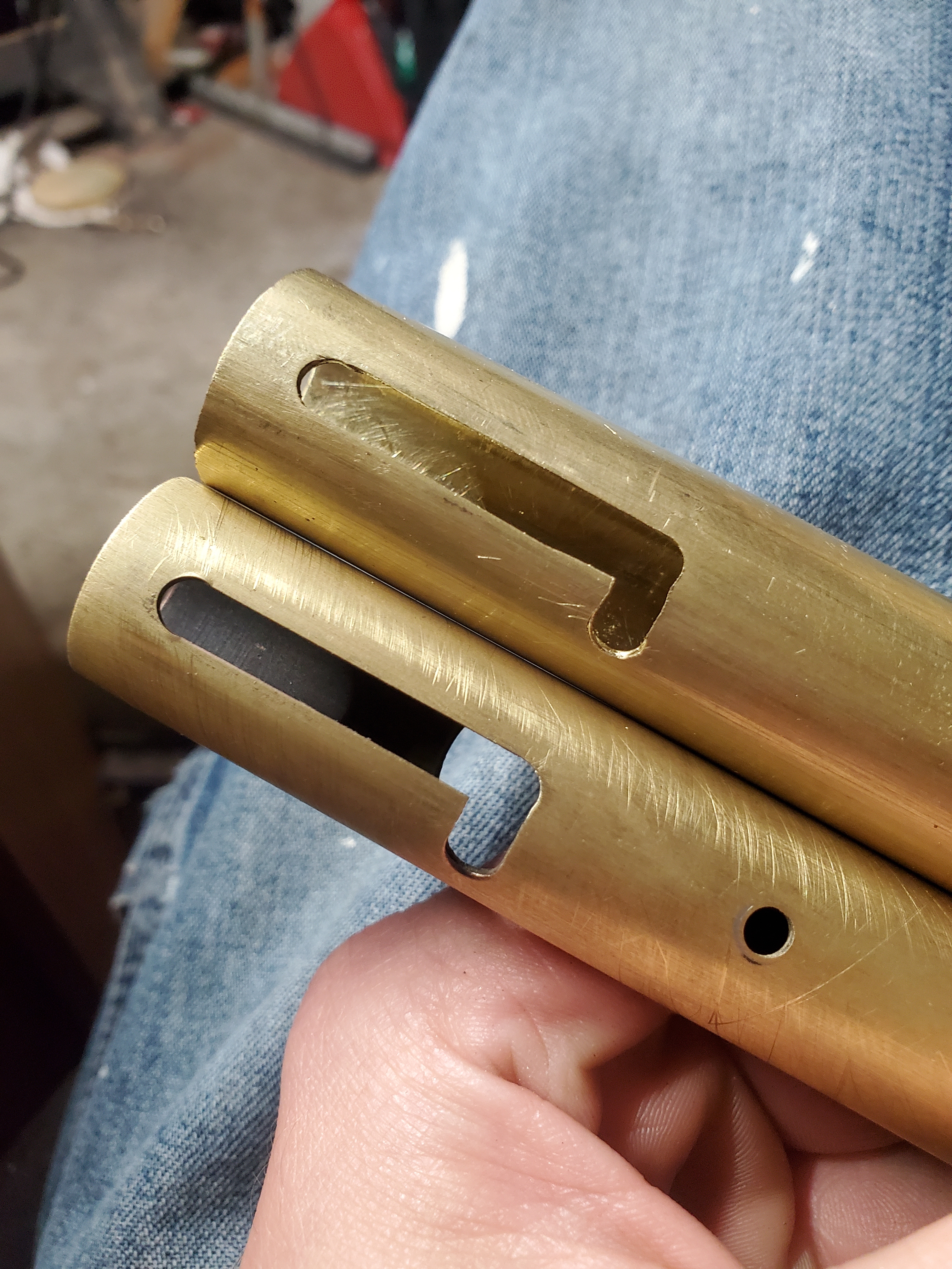

      Got the main slot cut today. It's not precise, but it will work, and it matches the original close enough.
