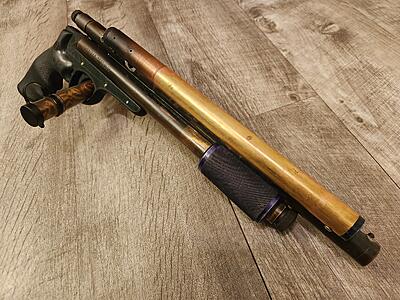

    So this P68 came to me with a feedneck sticking out of the right side of the top tube. I don't see myself playing with a hopper on 12's, so it was time to fire up the torch. Now I've spent all summer taking feed tubes off, and it's time to put one on for a change. I found this 21mm OD tubing on Amazon and it's perfect to use as feed tube. I grafted on a piece of leftover PGP tube I had laying around, and voila, a perfectly good P68 SC with the feed tube 45* to the right. It's a good start...

    Very SICK dude. It just feels like a good ol' days MCB post.
    Did you do the sight?
    • JeeperCreeper
      JeeperCreeper commented
      Nope the sight was already there
  • netsurferdude2
    • 879
    • North of Bawlmer
    Awesome job!
    • Rainmaker
      Der Printermeister
      • 1516
      • Cincinnati
      Dude! I like it!
      Just be careful with that Krain grip frame with such a front heavy marker. It's only plastic, after all 😉
      • JeeperCreeper
        Yea it's pretty much there for looks right now, it's already having some cracking issues at the front screw. Note the extra screw I put in the frame
    • GanonsGrin
      Skeet Surfer!
      • 524
      Can you post up a link to the feedtube you found on Amazon? I need some to finish off a convertible pistol build.
      • JeeperCreeper
        Unifizz Brass Round Tube Copper Tubing Pipe H65 21mm OD 1mm Wall Thickness 200mm Length Seamless Straight Pipe Tubing for DIY Draft Hollow Decoration Frame Models Hobby 1 PCS https://a.co/d/7NdFK0j

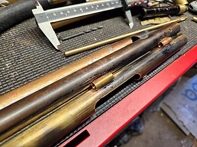

      Step 2: Cut a dropout slot. I'm getting pretty used to taking cutters to things that are perfectly fine already. This was my first one, and it went pretty smooth.

        Jordan commented
        Lookin' good!

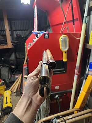

      Wait, what are these for? Stay tuned and find out after the break.

      • BigRed
        BigRed commented
        I'm guessing pump rod guides?
