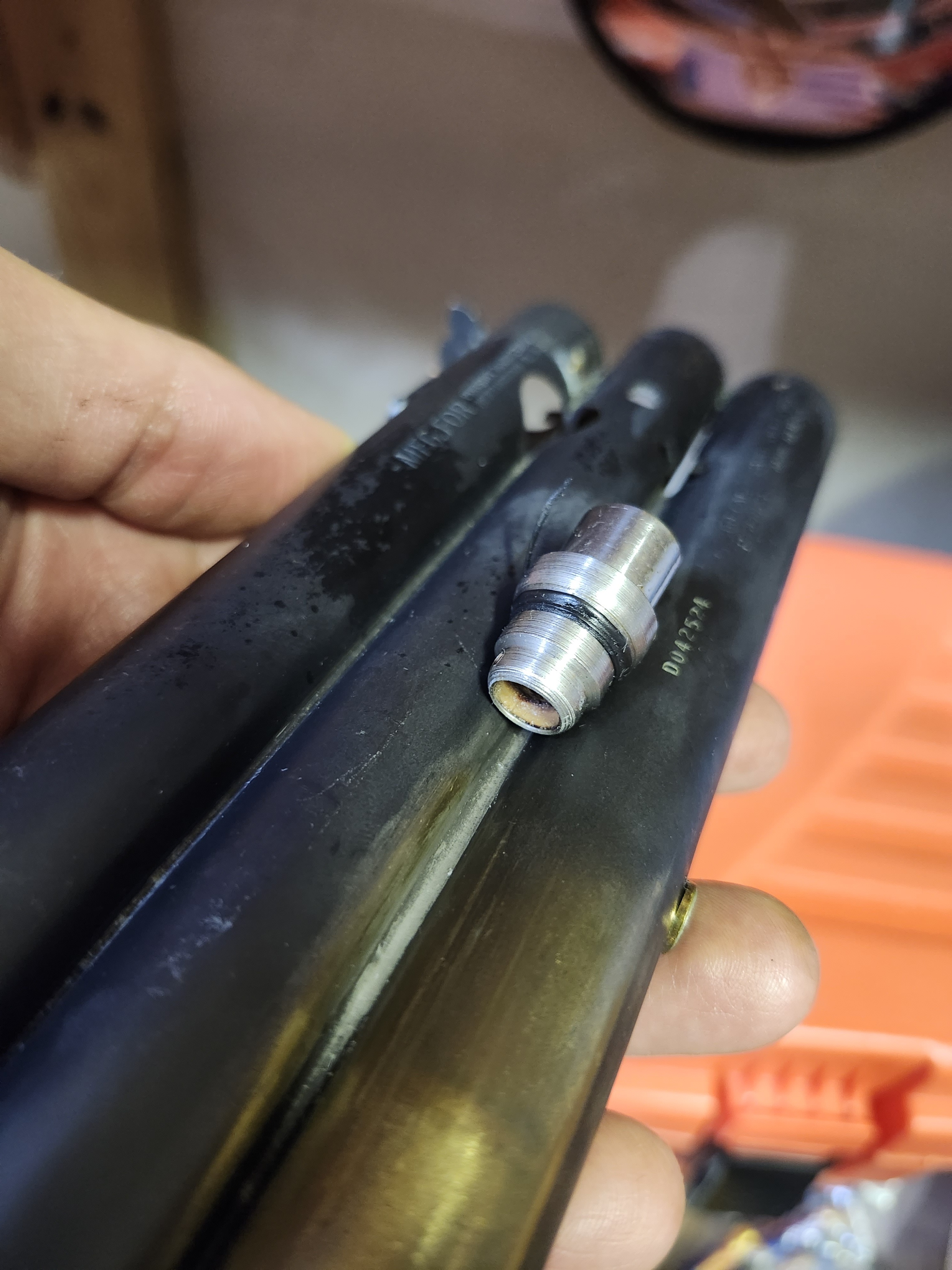

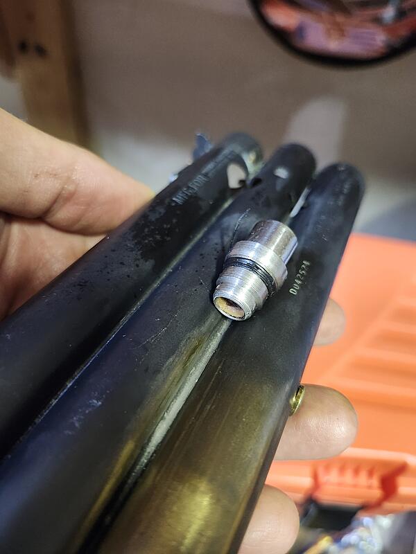

                Second Update: It's out!
                I used theBrickHaus method, thank you! I held the ~9 inch long dowel in place and smacked the dowel end against a concrete floor. After hitting it probably a hundred times with a rubber mallet I was really surprised when the plug popped out after 5 or 6 strikes against the concrete.​
                I still have a PMI-1 to do after this PGP and now I'm feeling way more confident about it. Thank you everyone for the advice!
