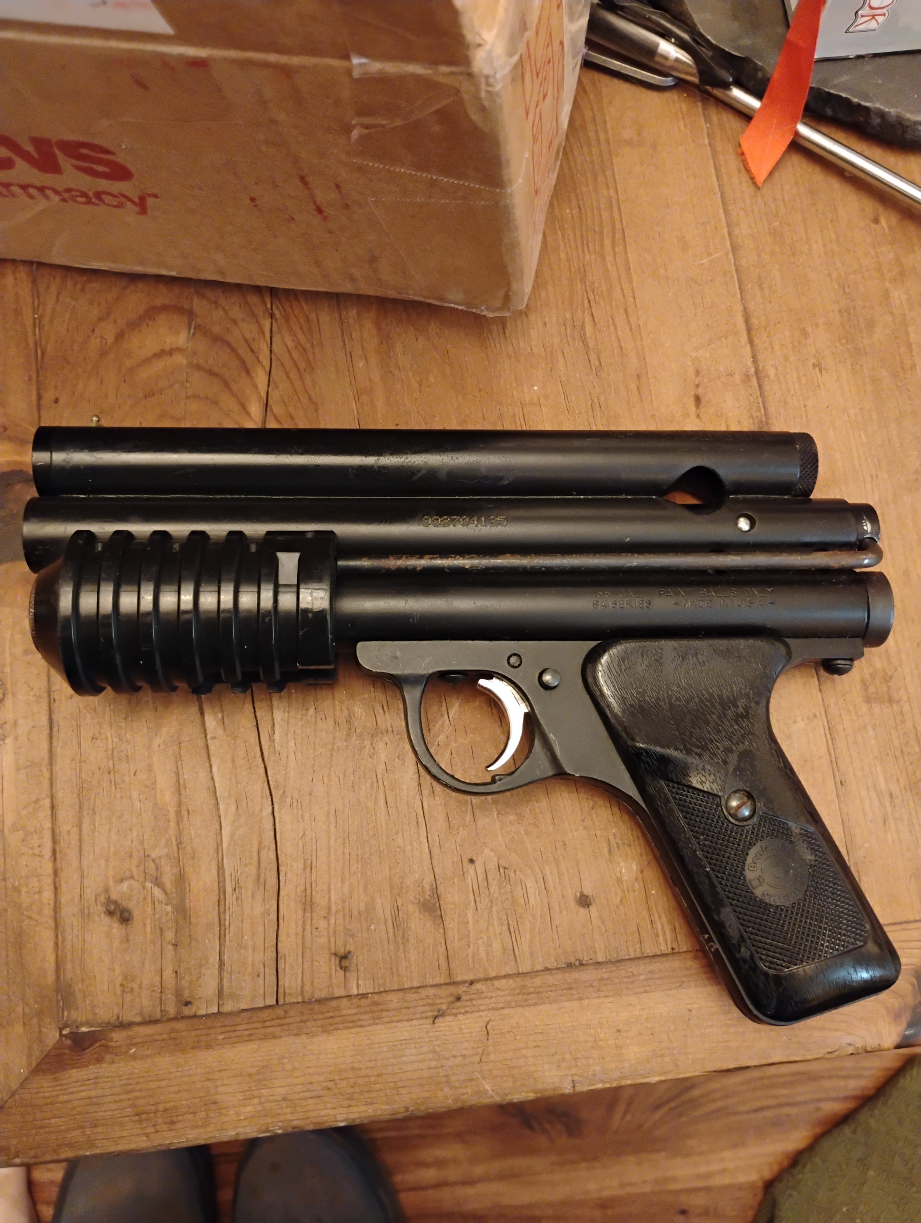

    Just received this bad Larry in the mail courtesy of Riot if you have coin he has wares. What upgrades do I need to make this playable? I'm assuming the speed changer for 12grams, some kind of speed loader, and a rear velocity adjuster. Any help with sourcing parts would be appreciated. Holds air and shoots but has a heavy pump stroke which I've heard is part of the charm for these.

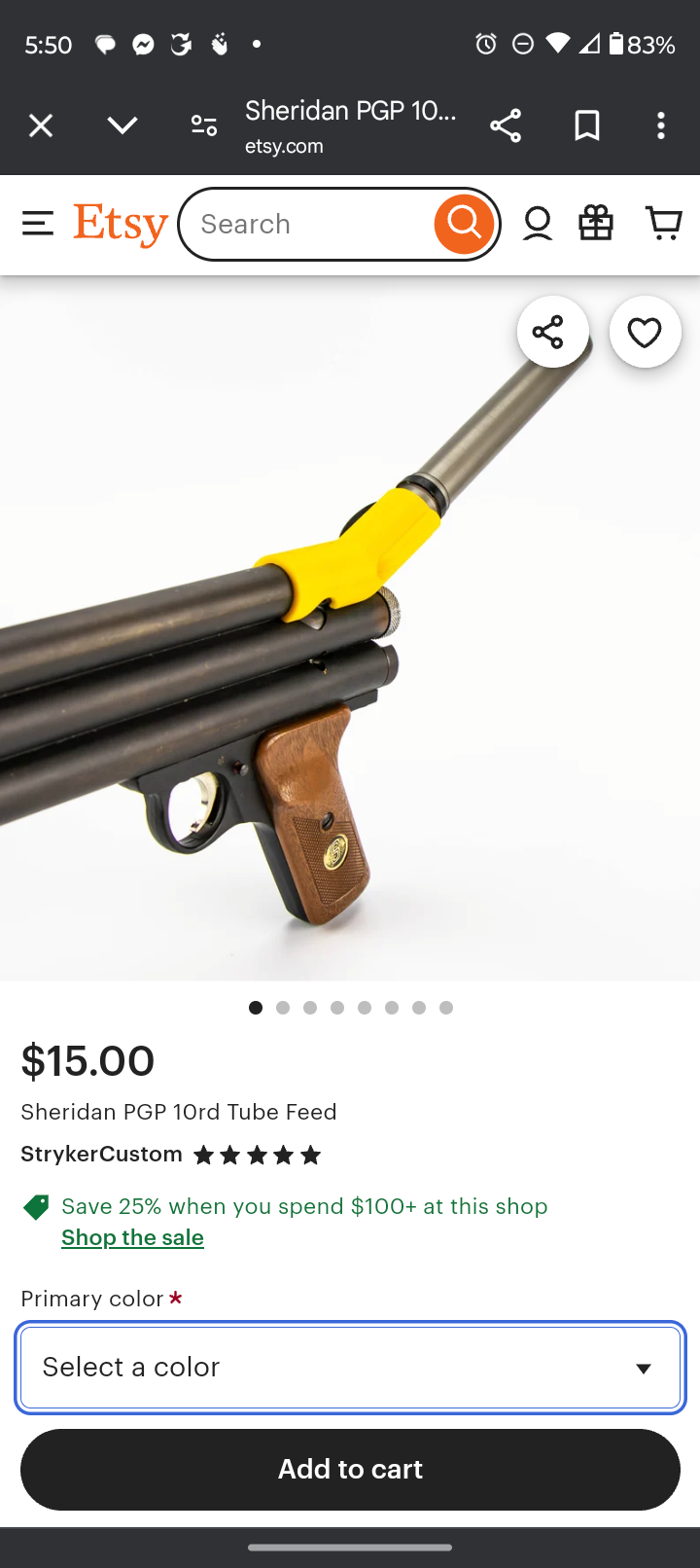

    PS anyone have experience with these Etsy 3d printed speed loaders?

    I don't have any experience with buying from Etsy or that seller. I printed my own. Since you are asking about buying, I mean, it looks legit enough and in the range I would sell for that kind of part.

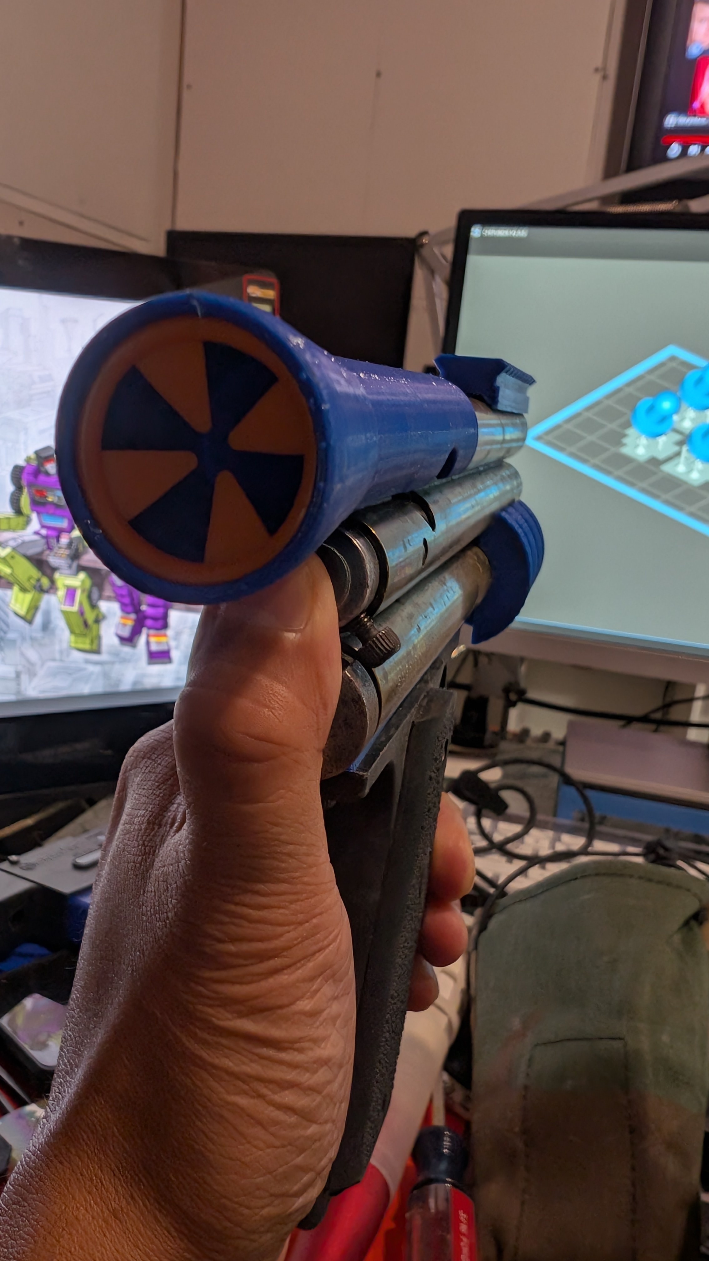

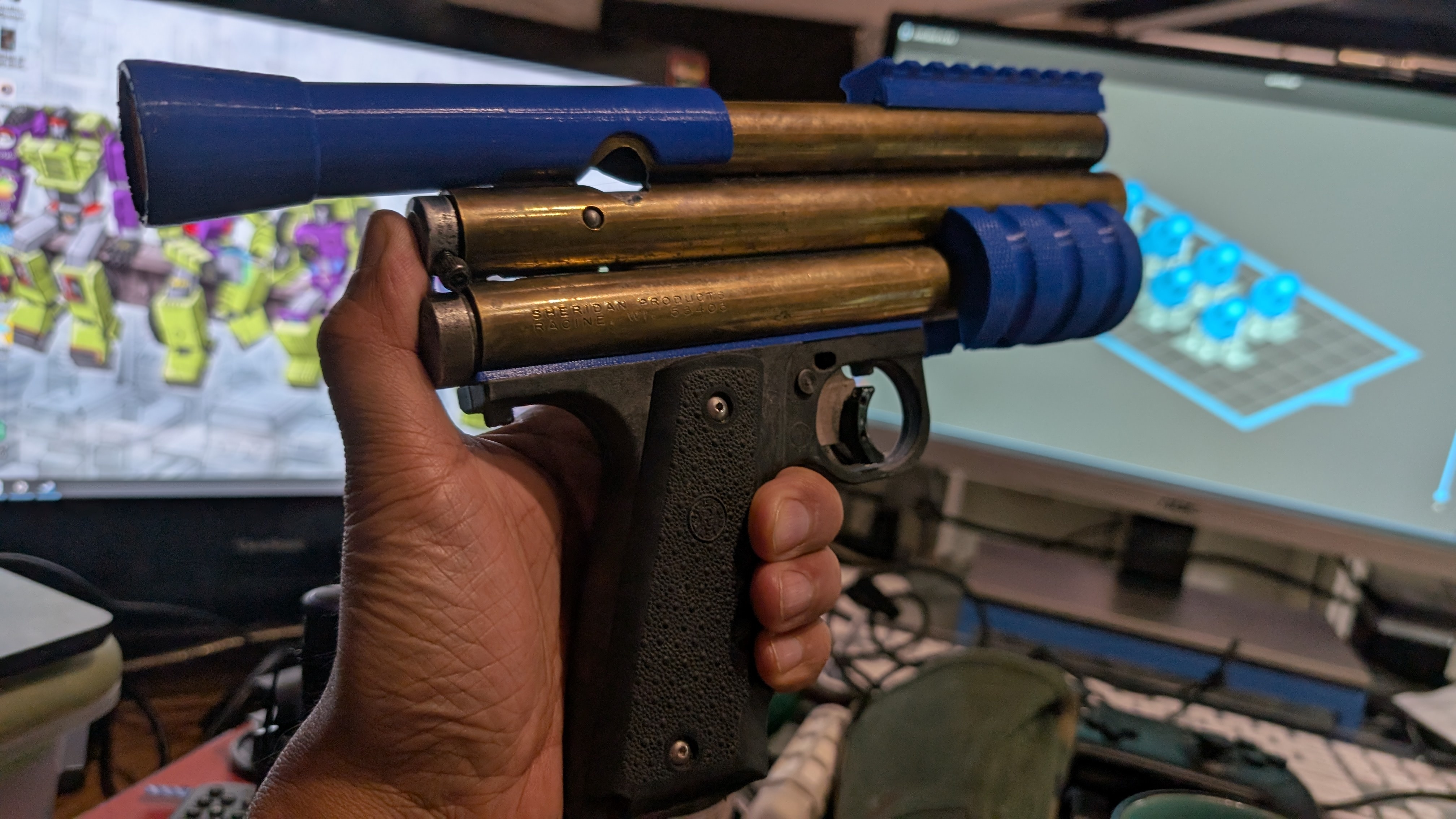

    Since it's a huge PITA to post pics in comments, here's my PGP setup...
    Click image for larger version  Name:	PXL_20241123_002029604.MP.jpg Views:	0 Size:	1.92 MB ID:	622877
    Click image for larger version  Name:	PXL_20241123_002043719.MP.jpg Views:	0 Size:	1.16 MB ID:	622878
    Picatinny rail, front cap, WGP grip frame tray (yes, that's a cocker slider on there ), Knurled pump handle, speedfeed. I really need to get around to hammering in detents...

      Very spacegun vibes, I like! Thanks for sharing
    • stockclass48
      stockclass48 commented
      I have that same speed feed 3d printed setup, however I can't figure a way to put a backstop so that it can feed reliably like the Palmers one. Looks good though!
