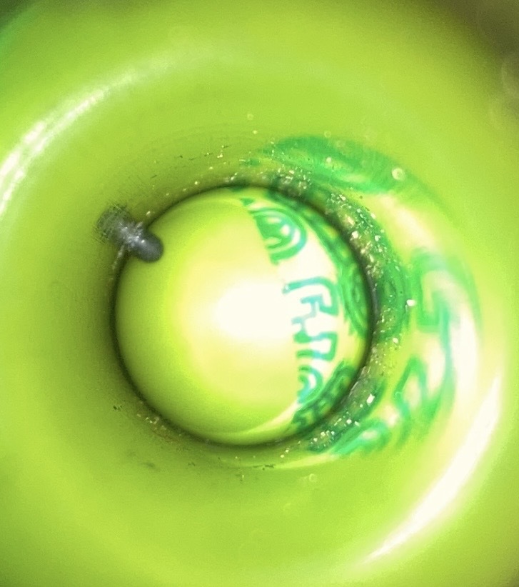

        i have noticed that s6 style ccm detents are mounted with the 'finger' coming through a slot so that it is able to fold out of the way when the ball passes over it.
        i setup a pgp with one, cut the same slot, and have noticed zero "flatline" effect. the ball flys straight, as if the detent was not there, but rollouts are 100% eliminated

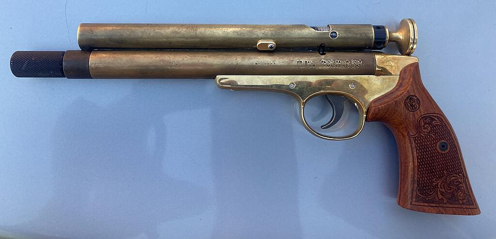

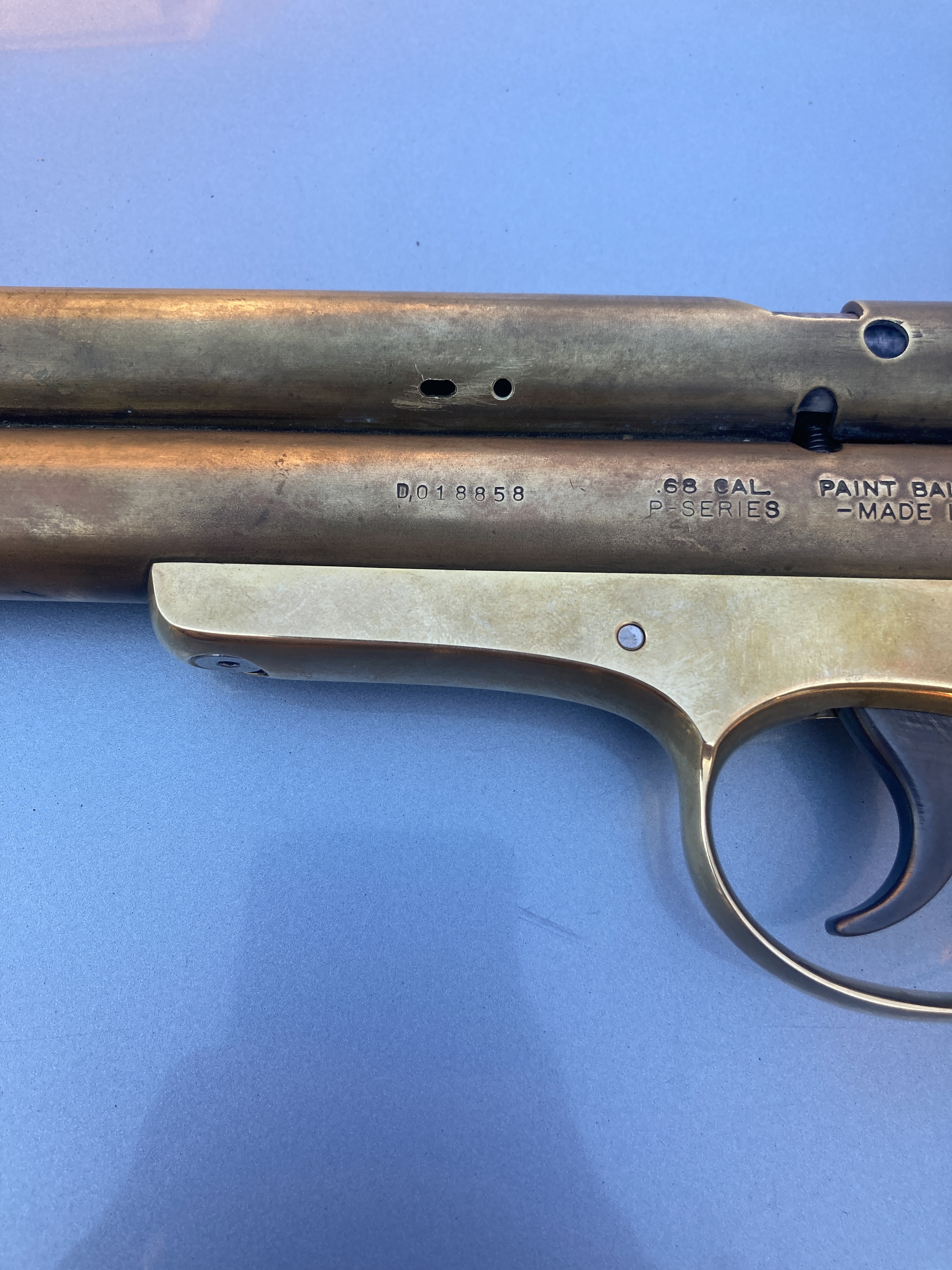

            i recently modded two of my pgps for spyder style detents.
            as ive commented above, i cut slots so the 'finger' is able to fold out of the way when a ball is shot past it.
            the flatline/galactic z/airsoft hop up effect doesnt happen on these. not sure if it was completely necessary as i never tested the detents with just a hole instead of the slot.
            and also like i said above, ive had zero drop in fps, efficiency or shot quality
            10/10 will always recommend

              I feel like this is one of the best options. It’s clean simple zero pew loss.
            • JeeperCreeper
              JeeperCreeper commented
              This is basically how I do them

            I did think of spyder nubs too. Seems as long as they retract when the ball passes.
            • $L!mBo
              $L!mBo commented
              yup
              like i said, this does not affect the shot at all

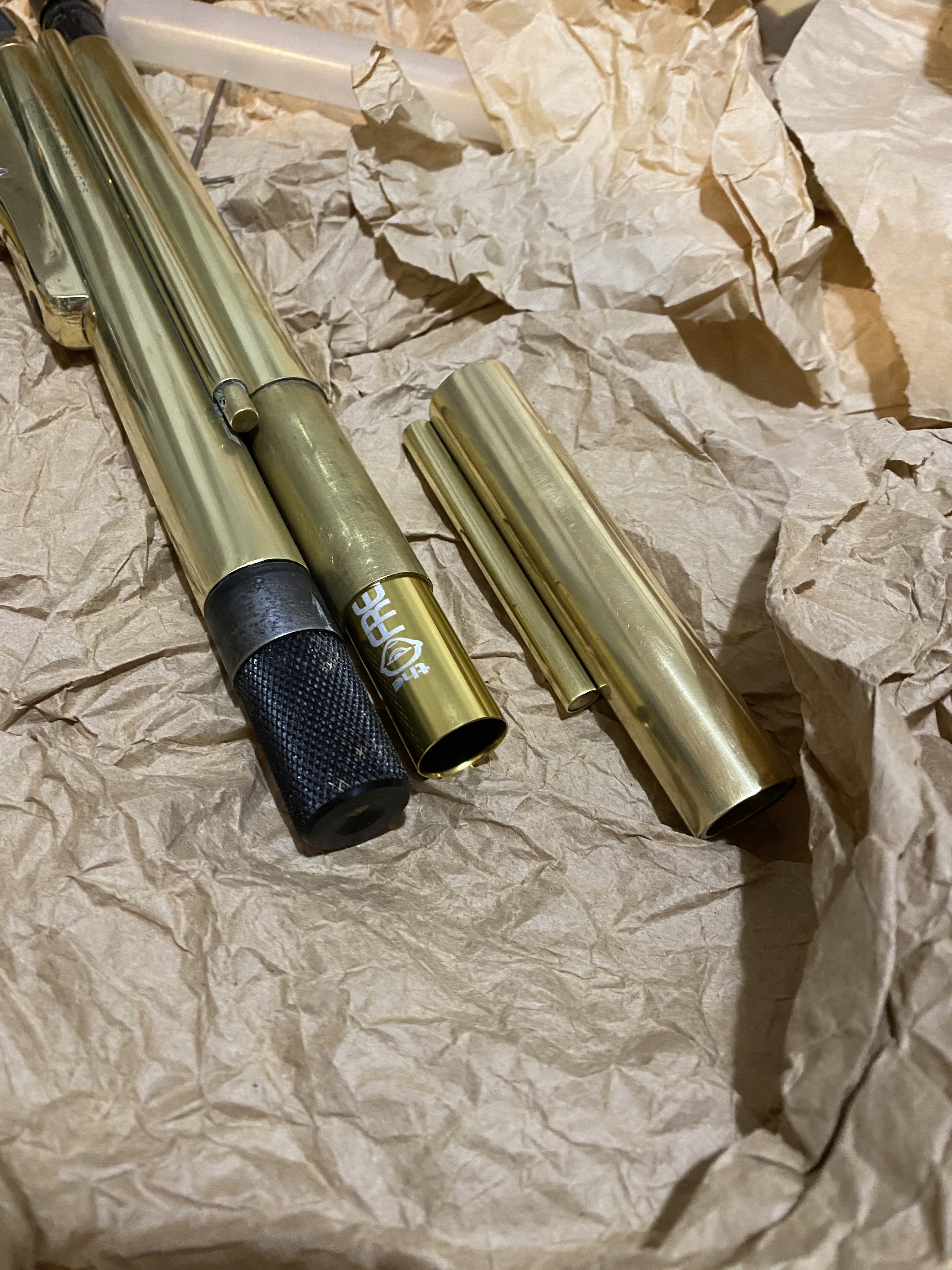

              top tube gets chopped and a larger, two piece is scabbed on where the insert gets sandwiched in and everything is retained by a screw
              iirc

            The one he built for me. Lots of options from clip on feeds and custom speed feed gates to freak standard/XL he can add detents and modify it for different bolts like mine is a center fire speed demon bolt it’s a lil longer so the breach it’s moved forward and cut to feed First strikes if I want. He can work the valve and body for better efficiency. He even made a bolt less one. This one was built for quick draw and single shot play. It’s one of my best shooters.
