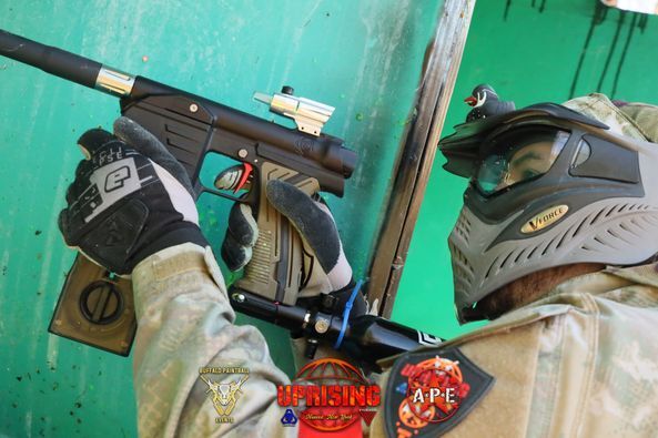

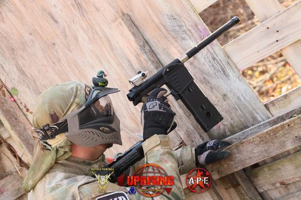

    This fall I shot my FLE100 body MG100 which just has an occluded red dot site on it (DYE Izon). Made some damn long distance shots at scenarios this fall, but plenty of just accurate midrange shots. I reckon I use it exactly the same way you use your DAM.
    I use a 10" hammerhead plus tip.
    I mostly shoot this by point shooting, but have it sighted in for midrange shots. If I have the drop on someone I can take my time and put the shot on target for sure.
