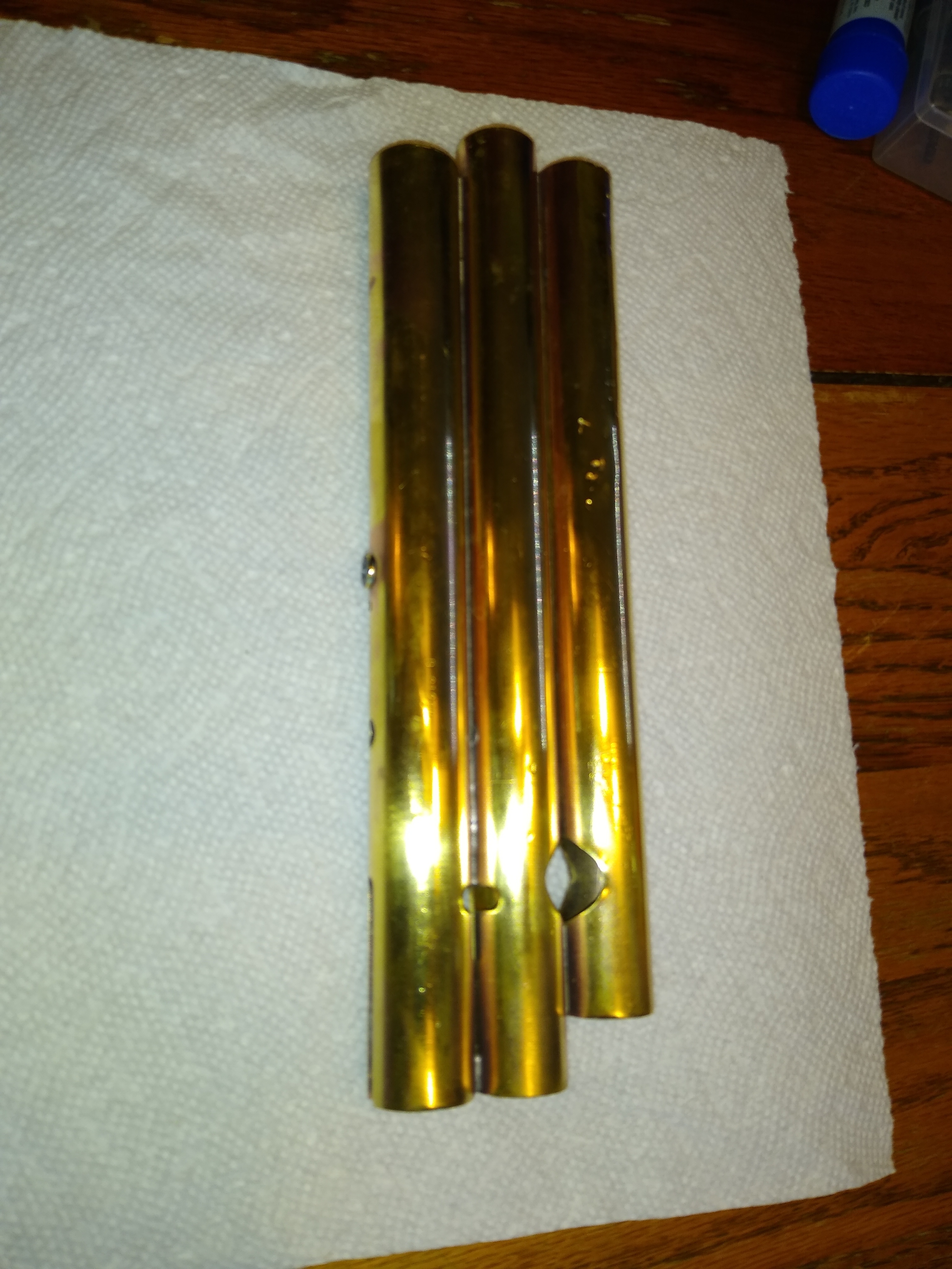

    So I just noticed this divot across the lower tube. I'm guessing this is to keep the pump handle in the forward position? It looks like a bb from an airgun might fit nicely in this spot if I drill out the pump for one. Am I reading things wrong or on the right track?

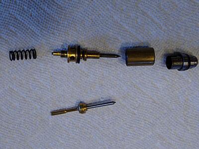

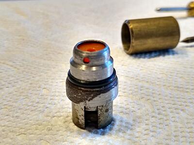

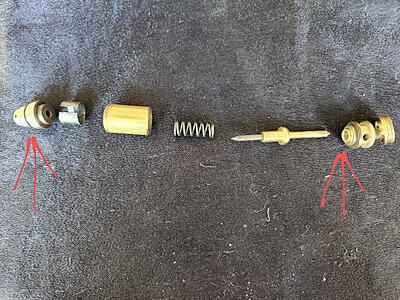

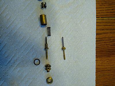

      So I was able to get the valve out today, it was definitely gunked out from some very dirty brasso (lesson learned haha). That being said, I wanted to ensure it was set up properly before putting it back in for trouble shooting.
      Could anyone confirm the parts are laid out properly? I also was wondering if the valve pin placed off to the side (from the PPS seal kit) would be a better option than the pin I'm currently using?
      The first and second photo shows the layout of the valve parts as best as I could tell they want to lay. The third photo show how the cup seal is currently sitting. The last two photos are just to show off how shiny I was able to get the marker with today's polishing efforts.

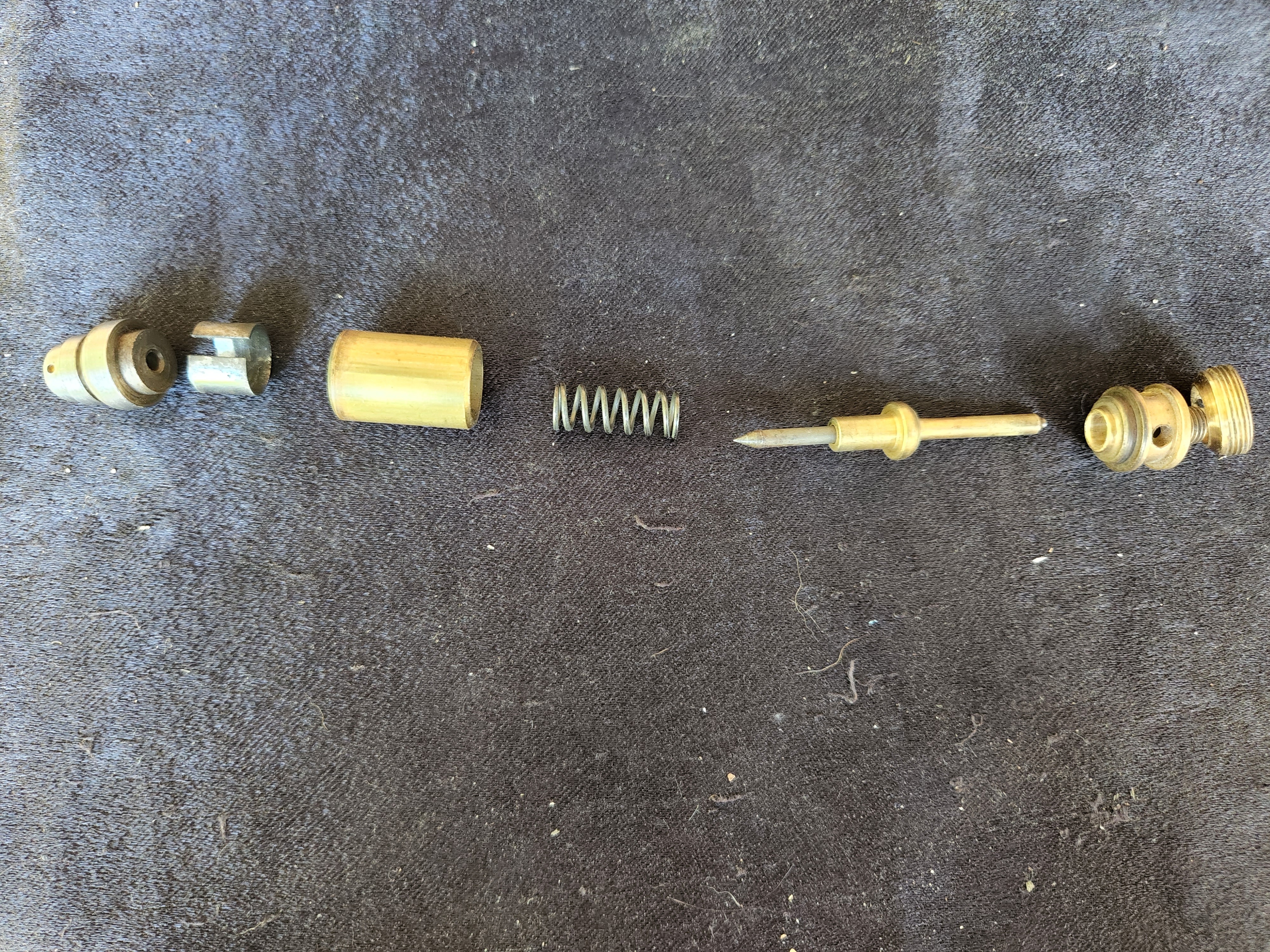

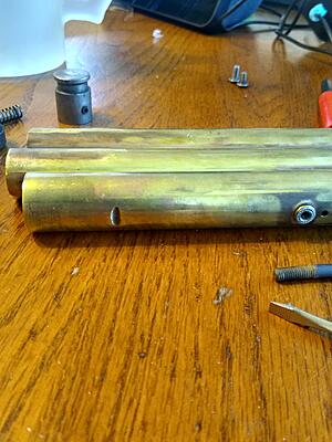

        #19
        Photos 4+5

          #20
          This is the order

          • JeeperCreeper
            Multi-purpose
            • 2127
            • Western MA
            #21
            Of course I forgot, you need seals here and here

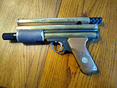

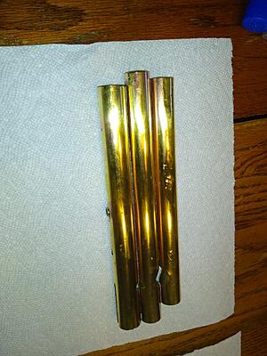

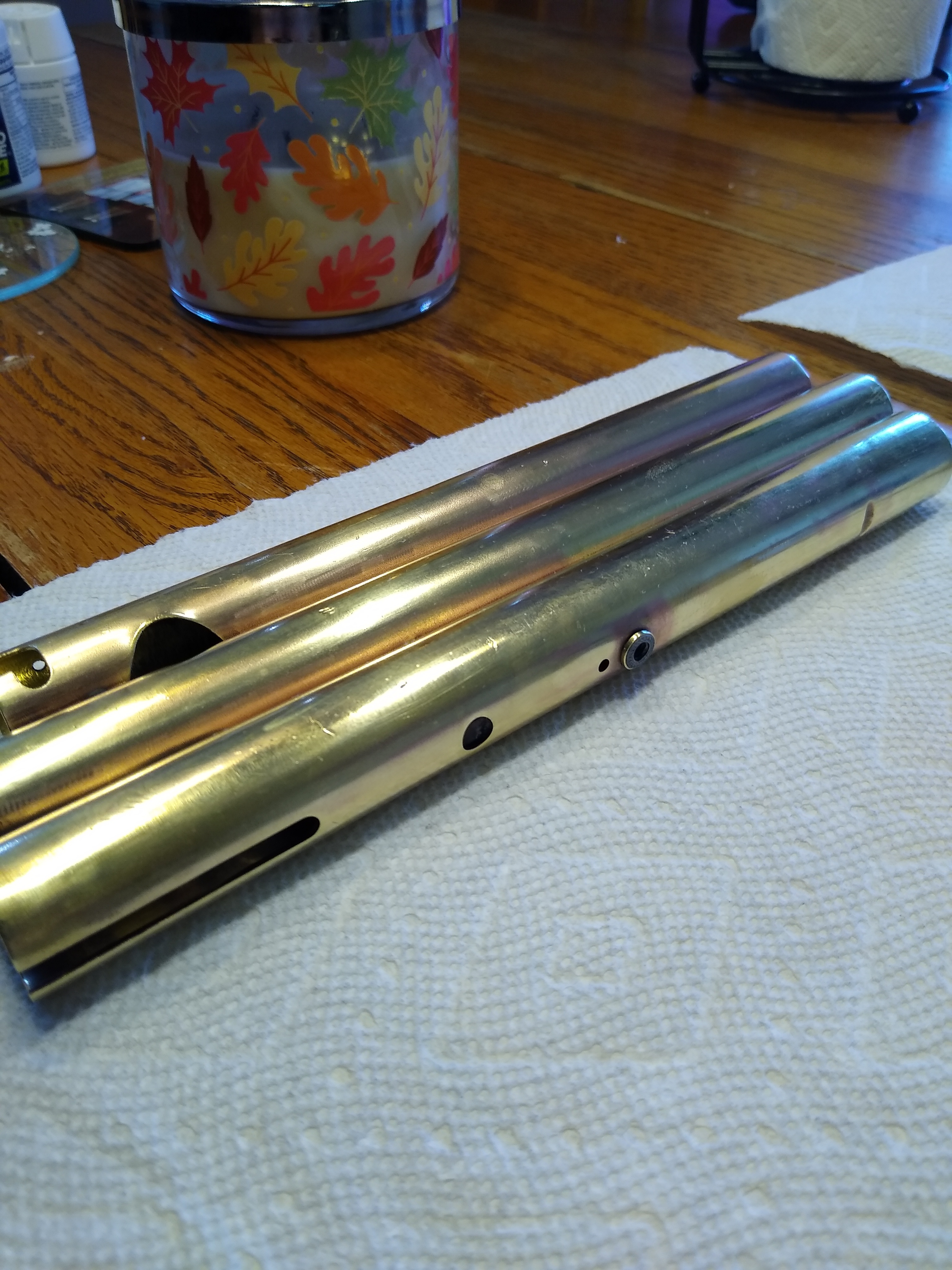

            JeeperCreeper generously hooked me up with a new pump handle bored out for a bb bearing, a front sight, and an entirely new trigger frame with a safety. With the PPS parts I got, this is how the marker currently sits.
            I was able to cut down a mechanical pencil spring, and used a .177 bb as a bearing in the new pump, it works brilliantly. I'll drill out the plastic pump I started with to match in case someone else needs a pump with a bearing.
            I plan to drill an allen key hole in the new frame, but
            I'm debating painting this one matte black rather than gloss, any thoughts would be appreciated. On a related note, does anyone know how to remove the safety from the grip frame?
            I also did a bit of research and found that drilling brass is a little more complex than I expected from my experience with aluminum and stainless. Apparently entirely different bits are required, so I was thinking I should get some practice first. Anyone have a good source for a comparable tube of brass to practice drilling on?
