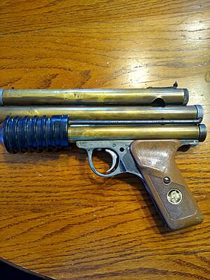

    Just got my first brass marker and I could use advice

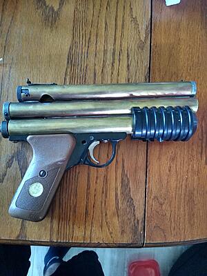

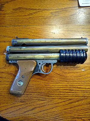

    So not long after my thread about the price of pgps I got a few offers and landed on a converted pg I thought would be a good starter project in terms of brass.
    My current plan is to do widgets according to the sticky, polish a whole bunch, then strip the frame and possibly repaint it. I've just got a few questions for the experts.
    As far as polishing goes my plan is to use brasso and a Dremel with a polishing bit after a few passes using rags. Obviously it's fine to hit the outside, but the inside could use a shine it would seem, is there anything wrong with polishing the interior of the tubes and the hammer/other internals with the aforementioned method?
    In terms of the frame I figure hit it with brake clean or paint thinner to strip away some gunk and the remaining paint, buff it out a bit with a light grit sand paper, dissemble it, plug the pinholes/screw holes and hit it with an outdoor spray paint or something? I'm kind of lost here as anodizing it just doesn't feel right for some reason.
    I'd love to hear from the experts as to any mistakes to avoid or if I'm using the right methods. And speaking of which I told netsurferdude2 I'd tag him when I made a post so here you go.
    I attached some pictures for those who are curious as to what I'm working with, sorry for the potato quality.

    Somebody get this man a sheridan front sight. I was clean out of them.
    Also if you want to try and knock some of those dents out of the top tube, bang an empty 12 gram down there (with the sight and front cap removed.
    • Impactfour
      Impactfour commented
      I was just looking into the front sight funny enough, and I love the idea of smashing the 12g through to remove dents. I'll add that to the list of stuff to do. Is there any reason I couldn't do that so all three tubes? I havent had the time to dissemble anything yet so I'm pretty damn clueless here.
    • netsurferdude2
      netsurferdude2 commented
      The barrel is a smaller diameter so you cant fit a 12gram down there, and the bottom tube is larger than the diameter of the 12gram and it has a soldered-in valve housing so it wont fit through. Just the top tube!

    Get a nice fluffy 12 gauge swab kit, put it in a drill with brasso, move it quickly up and down as you spin away will do I nice job polishing the insides.
    it’s messy do it outside with the gun in a 5 gallon pail.

      That's brilliant, I was getting ready to weld up an absurd Dremel attachment to make it long enough to fit the length, that would be much easier.

    That patina is beautiful. I would just straighten out the feed tube and get either a Kframe or just an RVA to get your velocity up.

      netsurferdude2 actually threw in a RVA, and I've got an order with PPS (if they ever process it) for a few parts.
      To be honest I'm not a patina guy, while I'm sure fingerprints will bug me, I wanna polish the tubes. Just not sure what to do with the frame yet, maybe once I remove the remaining paint I will just decide to polish it as well (I like shiny).
      When you say straighten out the feed tube I assume you mean the dents like netsurferdude2 suggested?

    You can chuck a barrel swab in a drill to polish the inner bore as well if you have an old one kicking around

    I don't think anodizing the frame is possible. It's cast metal for sure. I think these frames pre-date the development of cast aluminum that can be anodized. Either way, I've never seen one anodized, and I would be interested in the process of it were possible.
    • Grendel
      Grendel commented
      Yup they are Pot Metal frames not even cast aluminum. Clean up well, use an etching primer and paint (rattle can style) it will last a season or so before it starts chipping. If you really want a nice frame you can use a plate to adapt to a Automag or Cocker Frame. Good use for a Mag CF Frame.

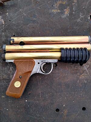

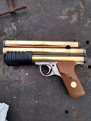

    Manages to make some progress this afternoon as I was working on land for once. Got a fair amount of polishing done on both the interior and exterior before the Dremel attachments wore out. I got started on the wedgits as well, but didn't bring small enough paint to feel comfortable going much further, I'll finish them off with some graffiti later. The frame was easy enough to strip, still need to prime and paint it though.
    Now for round two of the questions. Does anyone know the screw sizes for the frame, I manages to strip one of them when I mixed the two up. Additionally, it seems like the bolt isn't going back far enough when I cock it, I'm sure I reassembled something wrong, anyone have any guesses?
    Otherwise I'm loving this project so far.

      Awesome, thanks for the screw sizes. And it's cocking, but for whatever reason the bolt isn't coming back far enough for a paintball to fall into the breach. I'm guessing it could be that the hammer is backwards, but the marker isn't in front of me right now.
      BrickHaus commented
      Check the length of your hammer lug ( the set screw in the bolt) it should catch the shoulder on the back of the bolt, vs the face of the bolt.
    • JeeperCreeper
      JeeperCreeper commented
      Make sure the rear screw isn't too long and jamming up the spring. I just figured that out myself.

    BrickHaus was correct, it was the hammer lug causing the cocking issue.
    I've been drooling over k-frames for year now, but I'm going to hold off until I can play with it for a bit and decide if I like it before investing that much (although I did see someone was 3d printing a cheaper option that I may try before investing if I can get my hands on one.)
    ​​​​​​​For now I'm going drill an allen key hole, prime and paint the frame and wait for the pps parts.

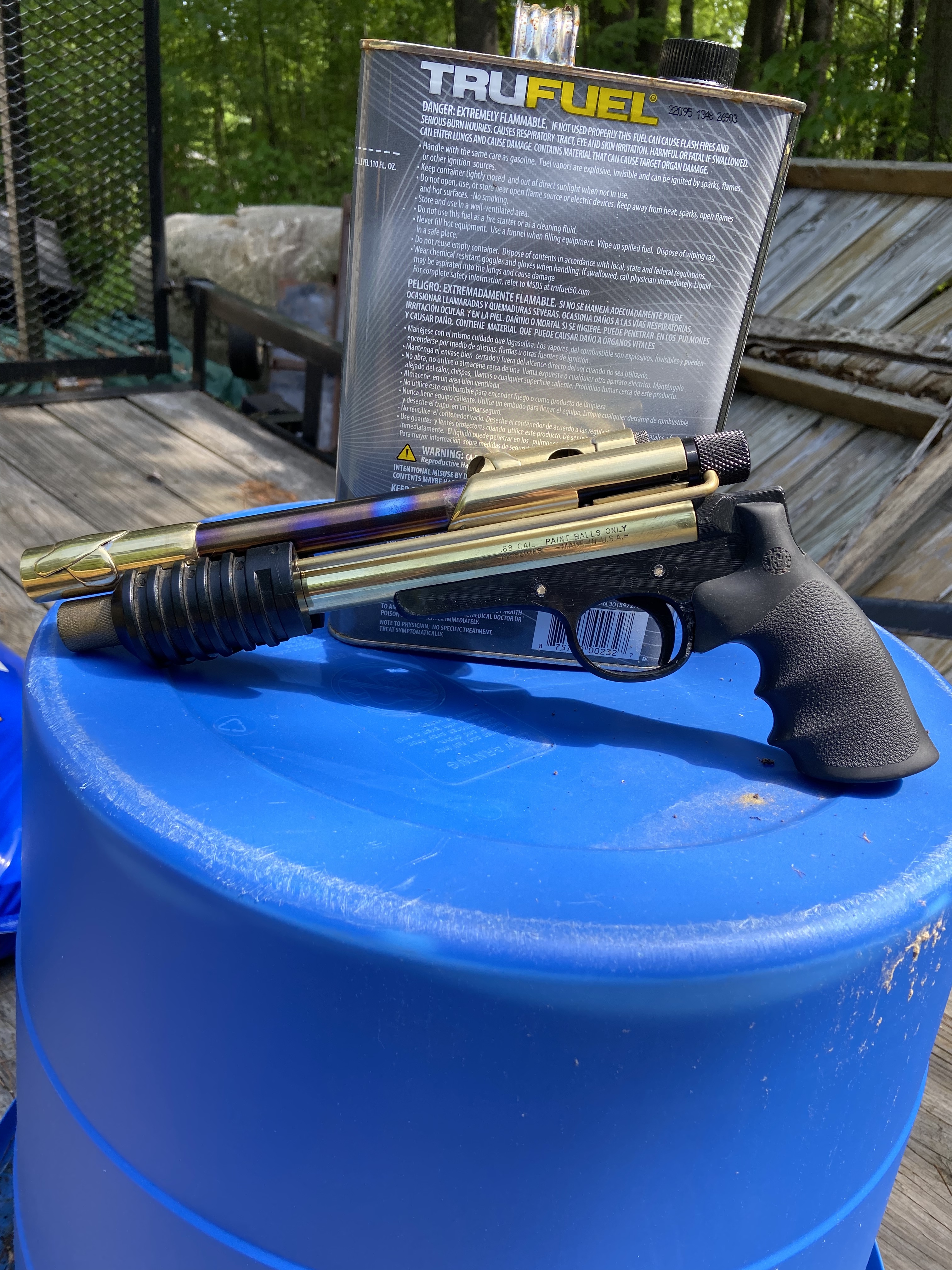

    The Krain. Rainmaker would have to make another batch and I don’t know if that is in the cards. Worst case scenario, if you don’t like it with a k frame on it, someone here would buy it. Here is mine with the Krain on it.

      That looks so nice for a 3d print, and I absolutely love the colors on your barrel there, how did you achieve that?
      Also I just noticed the trufuel in the background and got a good laugh out of that
      BrickHaus commented
      The barrel is titanium, thats a custom project by the great WALZ. He flame anodizes ( tortches) the titanium for varying color options. A greenleafs pistol is one of his many amazing projects.
      I too was blessed with a WALZ pirate with a TI barrel. Its been my main shooter since it showed up at my house.

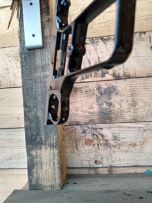

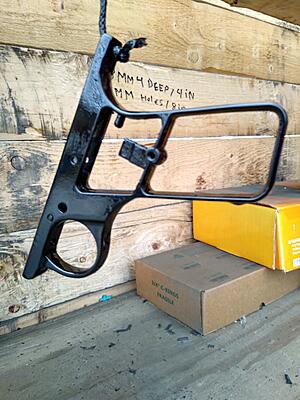

    Well I got the frame drilled, primed and painted today. I'm kind of digging the gloss look over the dust black the frame original comes with, but we'll see when I can put it all back together.
    I was also able to get the wedgits a bit more pounded in, 9/10 rounds of graffiti I brought with me stayed in place, so I think I will leave that as is for now.
    On a side note, I measured the grip frame screws today and one is 3/8th", while the other is closer to 1/4". I'm probably going to go ahead and get a few of each size screw just to be safe.

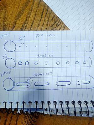

      I'm pretty happy with how the frame looks on the marker. While I'm waiting on the parts from PPS I think I'm going to cut a few windows into the feed tube for keeping track of paint, as well as for looks.
      Ill need to sit down with a measuring tape, but my plan is to start with pairs of small pilot holes, expand those out to 3/8th of an inch or so, then connect the upper and lower edges of each pair of holes with a cutting disk on the Dremel, leaving oval shapes cut outs, I've done my best to illustrate my plan in my 'diagram' below. I figure if I do the pilot and bore out holes correctly, I can go straight through the tube to get nice window cuts through both sides. Any thoughts or concerns with that plan?

        I don't see any issue, but afterwards, you're gonna need to sand down the rough edges inside the tube. I usually use a stick wrapped in 220 sandpaper roughly the size of the tube, and put it in the drill.
