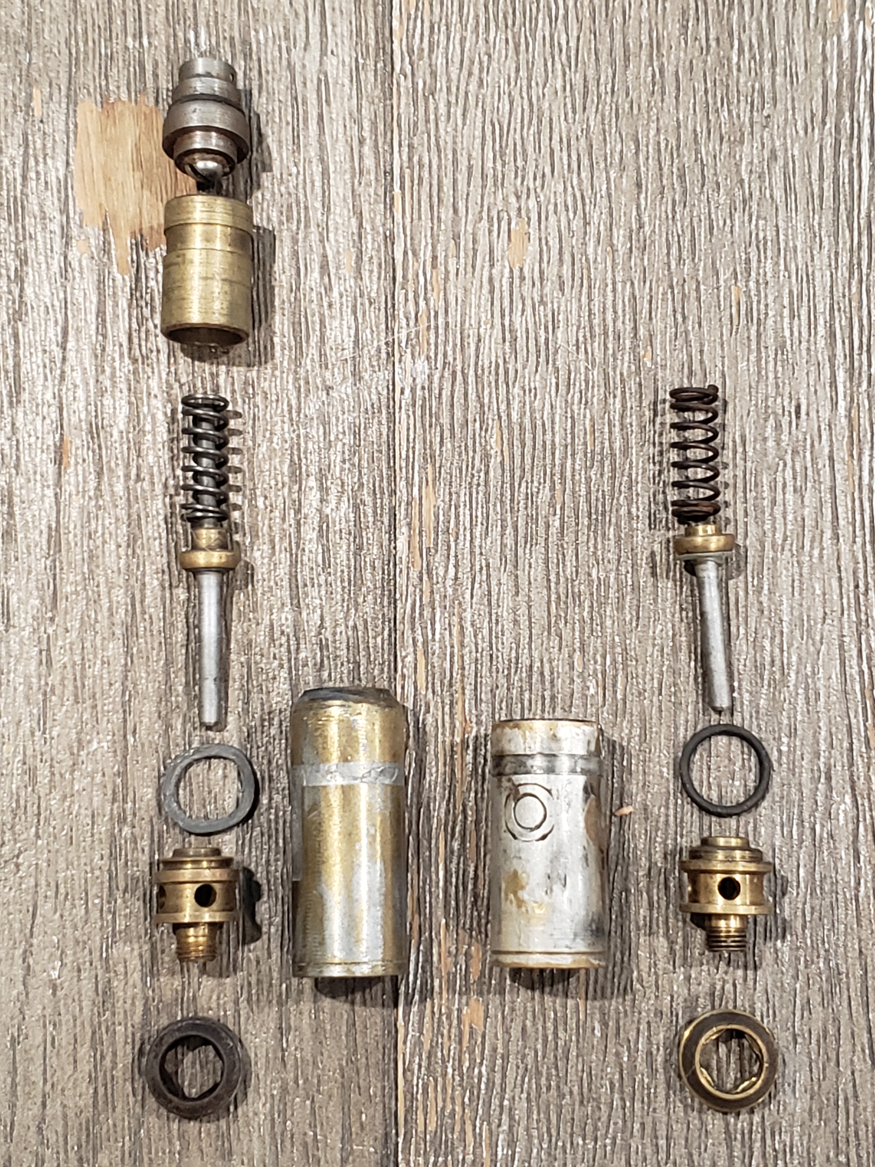

    jc nailed it, here's a quick pic of the internals layout 12vie vs. ca. you'll need a valve tool with the threaded core pulling end as the core can't be driven out. if the velocity is slightly low/spring isn't toast it can be shimmed or drilled/tapped for rva, otherwise any p-series spring will fit

      Autococker valve tools don’t happen to work, do they? Cocker retaining screws use hex- Sheridan is square?
      The image is super helpful!

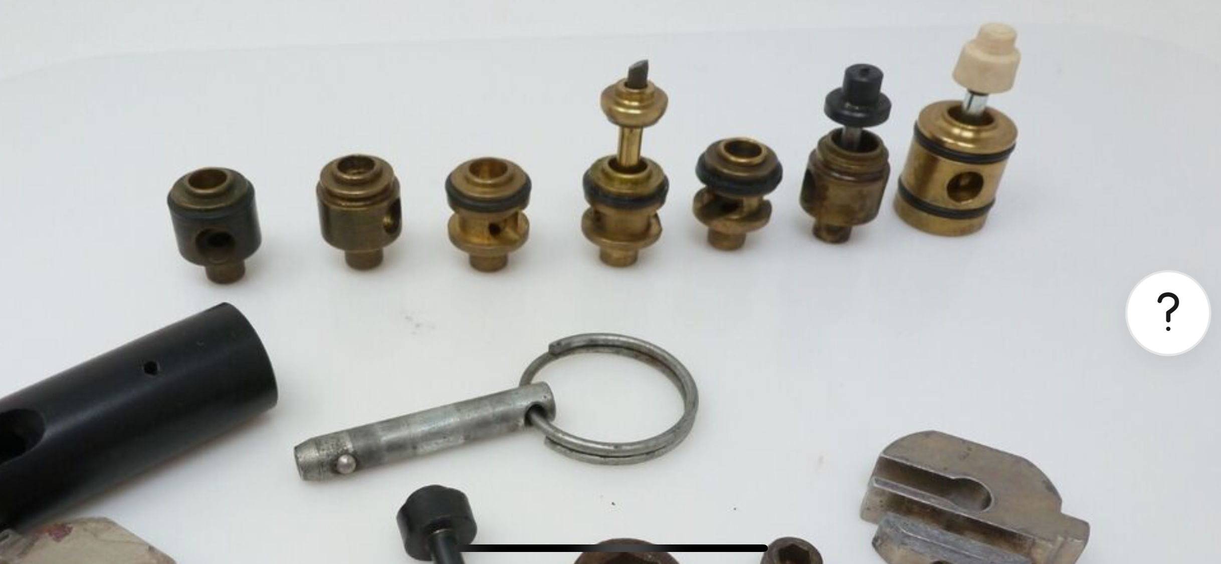

    I’m realizing that I’ve got several Sheridan valves now- I picked up a lot of like 8 various valves (from eBay I believe)
    and above post I think meant “jam nut screws” not valve retaining screw

    i guess “several” = 3 lol- one may even have remnants of an old broken piercer point

      If any one wants the little silver eblade noid holder things in the bottom right (idk if that’s even what they are tbh) I’ll mail it for cost of shipping

    And on further inspection- I don’t think my “Sheridan” valves have threading…. Hmmm

      Jordan commented
      Pretty confident you've got Cocker valves there. They're a touch smaller in diameter than a Sheridan valve, so they'll fit, but they might not seal up.
    • Hutbrew
      Hutbrew commented
      Gotcha- they were listed as “early autococker valves” thanks for letting me know they don’t seal- cuz my newb brain would’ve gone and tried 😂
