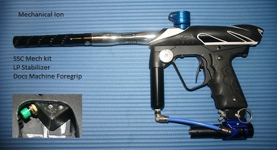

YES! Congrats! Throw up a pic in the sticky. I wanna see!Originally posted by steamburn View PostChoSanJusn,
With your guidance, I just finished meching my old Ion.
Thank you!!!
Fred aka ChoSanJuan
Team: With Intent

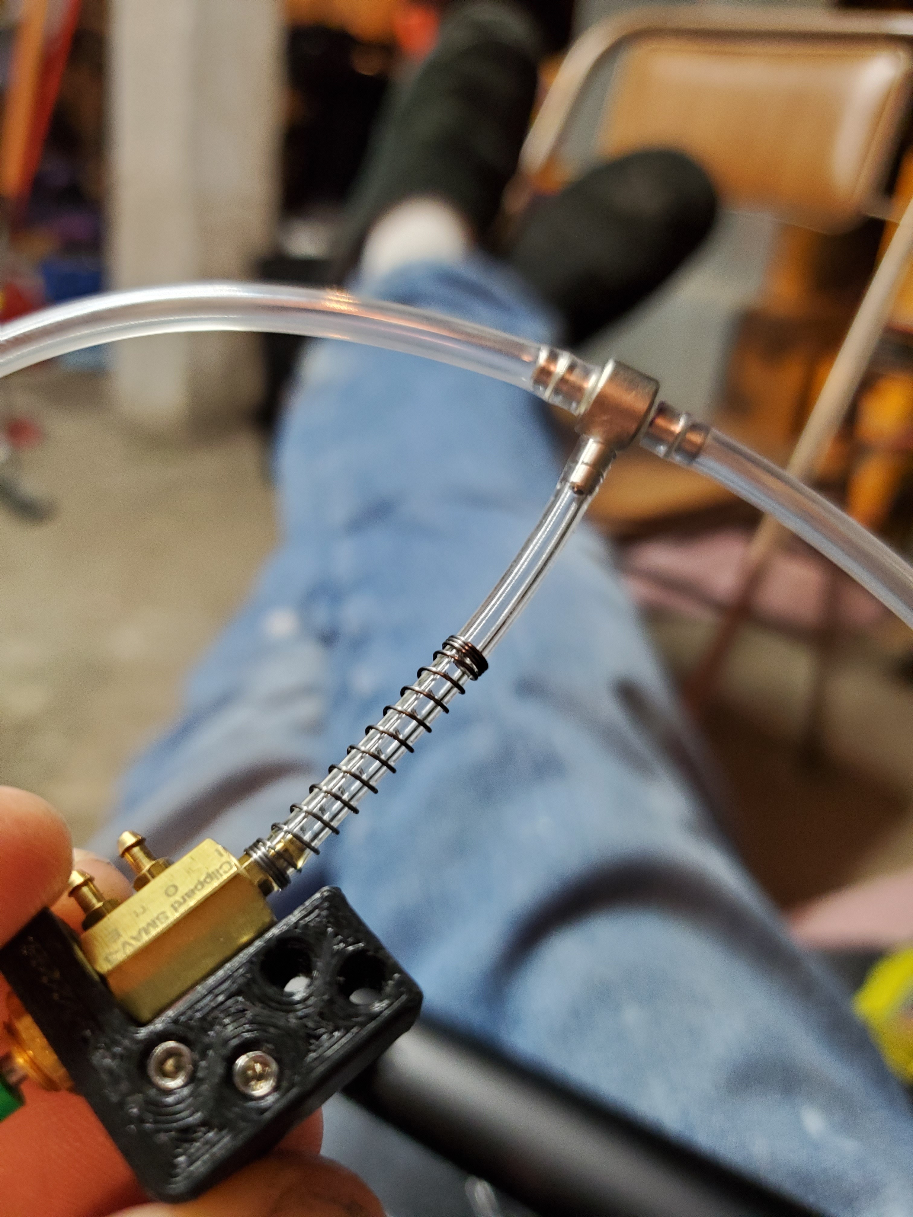

I put this one together yesterday;
I ran into two minor issues;
1. You have to make sure you use the right trigger. I found that one where the geometry is similar to a stock trigger worked best.
2. Hose routing - make sure they are longer than needed, and cut them to fit so that there are no kinks. Make small cuts, lots of trial fits.
I used a pen spring to prevent a kink on the line going to the QEV.
I used a 360-QEV and a dual oring Shocktech bolt.
I fit the SMAV first, and worked my hoses from there.
The trigger is definitely different....
